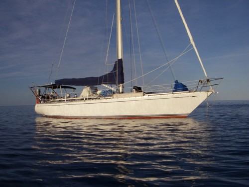

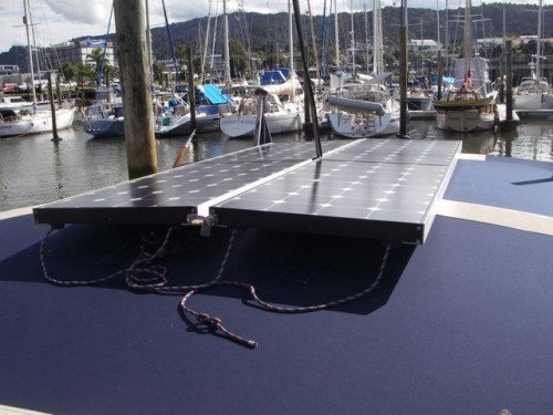

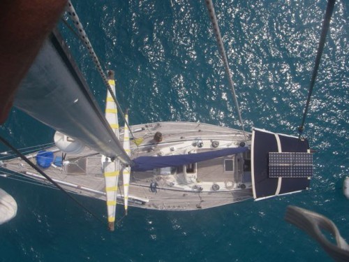

Hello everybody,
here a few pics about our solarpanels on the large bimini. This setup is very light, comparable pleasing to the eye and did 45.000nm incl. our circumnavigation with no issues, even in 55+ between Tonga and New Zealand so far. Panels are Sunpower 4x90W, making the boat almost self sustained, despite fridge, 30l watermaker, washingmachine. The boat is S&S - 47/013 VERA

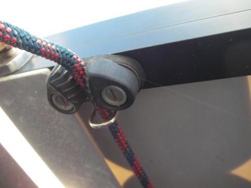

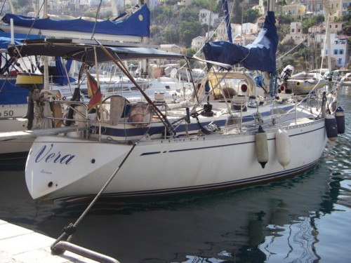

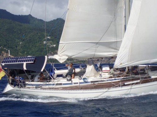

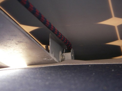

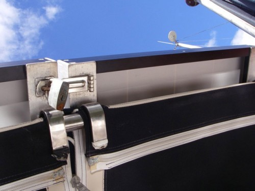

Hi Mike,
here are a few more pics. Boat looks dirty, do to lots of miles, sorry for that. Refit is underway.
Best regards,
Michael
27 February 2011 - 15:09
Join Date: 01 July 2010
Posts: 48
+ some details
