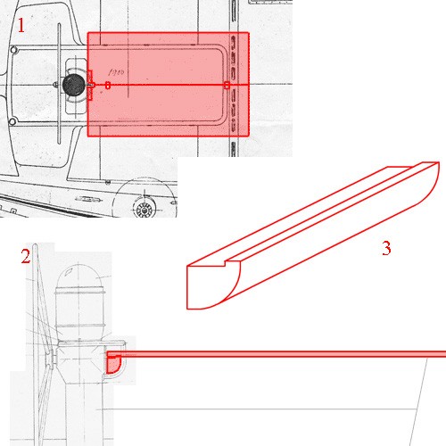

We have a 431 too and some years ago we've designed a very simple table that is working really good. It's made up only by the surface (that's splitted in two part using two hinges) and a piece of wood properly shaped to fit below the compass (it hasn't lags!). Here I made some sketch: 1) from the top, 2) from the side, 3) the piece of wood that hook the table under the compass.
When you aren't using the table, you can quick fold it and put it under the pillows of the right bench of the saloon (so it has to be less thick than possible). Best regards
Francesco (431/012 Caid)
29 April 2007 - 14:42
Join Date: 10 February 2007
Posts: 3
Clarification: the table haven't any permanent fitting, the piece of wood too has only to be inserted when you set up the table. The other side of the table lean against the boat herself (on the rise before the entrance)

Thanks very much for your suggestion and taking the effort making the drawings.
You have an simple elegant design with no fittings on the boat and
I had a similar one, not as elegant as yours although:-)
What we would like is an original design, even though it means permeant fittings
on the pedestal and the cockpit wall.

Thank you, Francesco, for your informative drawings!
