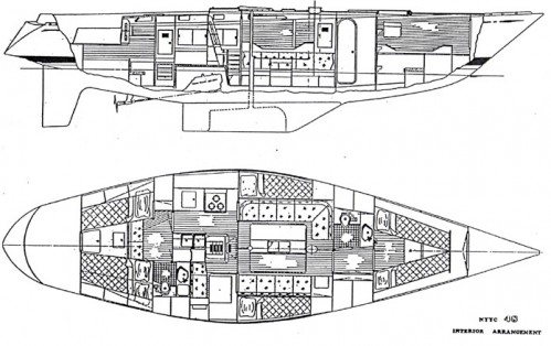

Can anyone tell me differences, if any, between the Swan 47 and the New York YC 48

NYYC 48 is basically a 47 CB, version II,  with aft entrance

The NYYC 48 is a Swan 47 with the following changes:
1 ton more displacement as shallower keel and more ballast
stainless steel centreboard
mast 2ft shorter for intercoastal waterway
longer boom
accomodation moved 2 foot aft which means wider saloon, larger heads and forecabin and smaller aft cabin
larger tanks
I am biased as I own one, but I think this is SS at their best. Great cruising capability with shallow draft, combined with similar stabilty to deep keel boat and great racing performance - we were 5th in the competitive Swan Cup this year on Black Tie.
