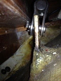

Dear Cliff Deck lifting locally is a structural problem, and a common reason is that the chainplate knee inner ends are not properly supported against the coachroof coaming.
Suggest you send photos of the knees for evaluation.

Dear all Although the tie rod approach seems obvious it intrudes in the interior, and I would suggest another way. Pls see old thread https://www.classicswan.org/forum/post_thread.php?thread=149 Kind regards Lars |

Hi Cliff, The problem of the decklifting is also there on my boat (Swan 40, #22). I am very interested to see some pictures of your solution. Kind regards, Jolling Lodema NL |

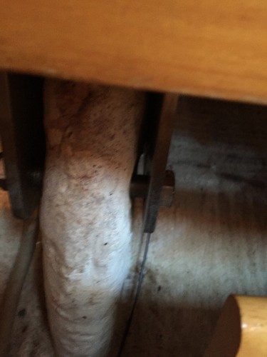

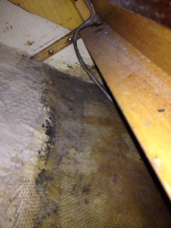

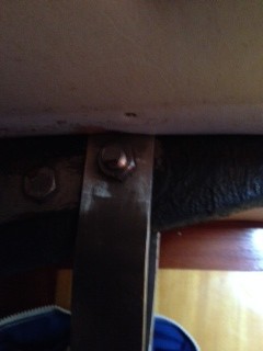

I was concerned, just like you, about my deck pulling up by the chain plates. I removed the fiberglass covering on the inside over the pilot berth and found that someone had added fiberglass over the knees and black gelcoat that had never cured. It felt sticky but because it is covered it did not matter apparently. It bothers me a little, but really does not matter much. But did it solve the problem of the bulge on deck? Was the reinfocement done when the deck had already pulled up? That was about four years ago and at that time I made a template I could lay on the deck and it conformed to the deck and the bulge. The bulge was about 4 mm on port and stbd about the same. My rigging is wire on the lowers and rod on the uuppers. In the Winter there is less tension because the mast becomes a little shorter in the cold. In the Summer the rigging is set up to just become a little loose on the leward side when I am heeled about 15 degrees on the wind. It the about four years since I have not observed an increase in the bulging. I agree with The Professor that the knees are not adequately supported near the cabin house sides or. rather, the support is not carried enough inboard. The evidence is hull number #1 which I inspected at Port Townsend in the State of Washington. #1 has a plywood deck and no liner on the inside. Picture attached. The cabin sides st squarely on the deck, it forms a suare corner which is much stronger that the rounded corner we have on the molded deck. My boat appears to be adequately reinforced, but I'll keep an eye on it. ![]() |

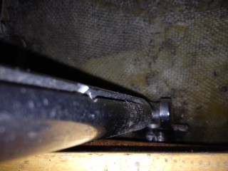

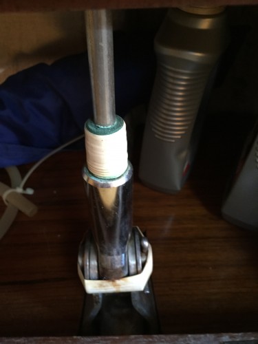

Hi Guys,
It took a while but attached is the file describing my setup for supporting the elbow and stopping the deformation of the hull and deck.. A prettier job could be done but this has served me well over many miles!! Any questionsor comments are welcome!!!
Mike from Stormsvale |

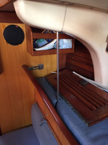

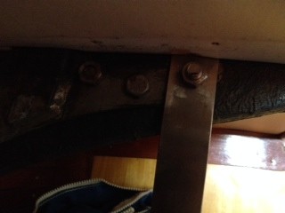

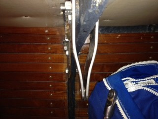

Maybe I can help: Mike was so kind and sent me these pictures from his repairs to his boat. His rig became slack at sea and it is a testimony to his seamanship that he didn'd loose his mast and was able to sail 500 miles into port where he made these repairs. A true sailor! Iam sure there are Vikings in his ancestry |

and some more: |

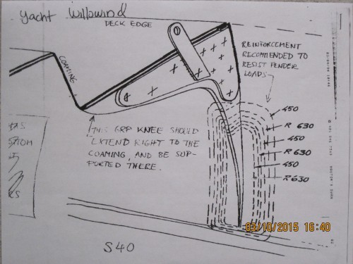

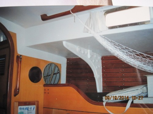

And here is what Willowind did: |

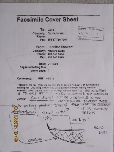

And here is The Professor's recomendation. It oes not intrude on the use of the pilot berth and I have slept in the pilot berth, so has my crew. The pilot berth are very useful to sleep-in at sea: they are just in the right location and you are very secure ![]() ![]() |

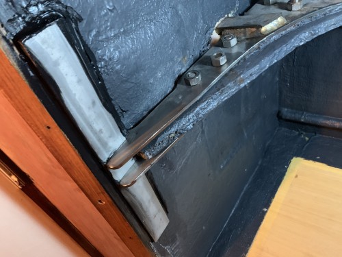

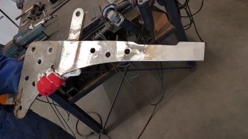

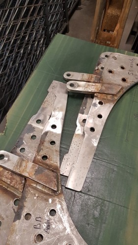

Dear Swan-friends, For the coming winter I have some plans for my boat. After a nice weekend with a lot of wind, over 40 knts, I decided finaly to do the reinforcement that Lars suggests. In short, I will go for the solution with the extra knee. The suggested material for the knee however is GRP and I am considdering to use Aluminum or Stainlesssteel instead. I am very interested what you think about this suggestion in case of strength, connection method with the hull etc. Kind regards Jolling Lodema |
Join Date: 14 May 2017
Posts: 66 |

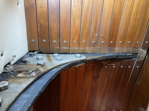

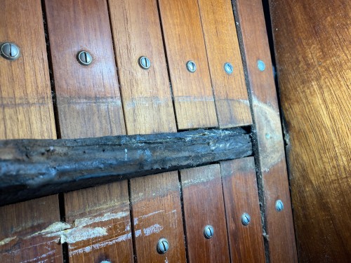

Hi dear friends, Started my work. Here some pics. More will follow! Jolling ![]() ![]() |
Posts: 66 |
Making progress! ![]() |
